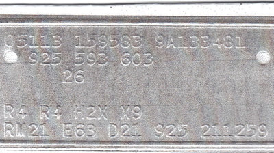

This is the copy of the fender tag. What do you think and what does it mean?

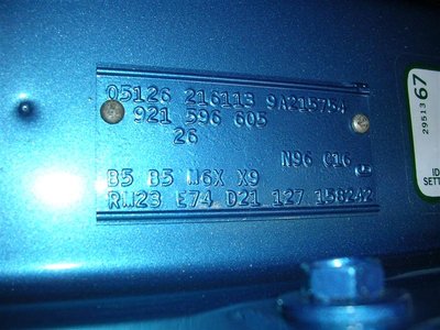

Not bad. Here is my tag to compare

Looks like the "593" is wrong. From what I've seen from your posts, you have an axle package car. The choices are:
591 - 3:55 8 3/4 sure-grip with 10" rear drums and front discs
594 - 3:55 8 3/4 sure-grip with 11" front & rear drums
642 - 3:91 8 3/4 sure-grip with 10" rear drums and front discs
643 - 3:91 8 3/4 sure-grip with 11" front & rear drums
Is your rear original? Does it have the ratio tag? Did your car come with front discs?
EDIT: Guess you can rule out "591" & "642" since all 'Runners came with 11" brakes.
EDIT #2: Oops.... Used the word "all".... 11" drum brakes were standard equipment. If equipped with front discs, then the rear drums were 10". Sorry.....

What does the 593 indicate? I'll check to see if there is a ratio tag. No the car did not come with front disc brakes but I did install them recently.

"593" is a 3:23 single track rear. It is a non-sure-grip unit and is sometimes referred to as a "peg-leg". The only way your car would have come with that axle code and the "26" for 26" radiator, is if it came with A/C. As I recall from past posts, your firewall did not have the provisions for A/C. Therefore, one could conclude that your's was an axle package car, and thus could not have had the "593" axle code. I suppose your firewall could have been replaced or patched...anything's possible....
We're getting into the realms of "never say never" here, but that's the jist of it.........
