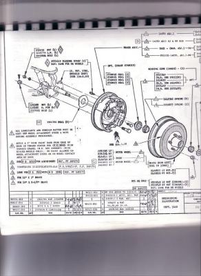

If you look in the lower right corner of this document, it has a date of 1/31/69. It is hand written.....

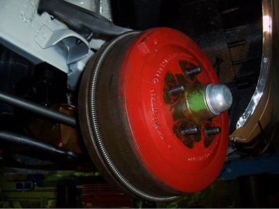

From the looks on my original rear drums it has about a 1-1/2" wide ring all the way around and with a run in it.
To me it looks as if they just slopped the ring of paint on in one motion without stopping till they met/completed the circle.

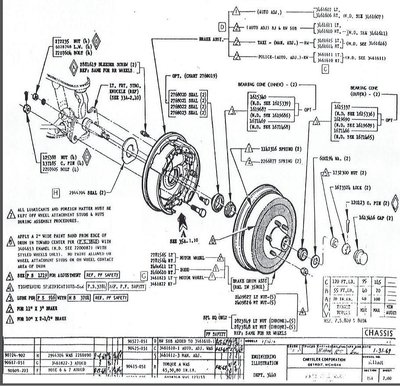

Here is my answer to your question from Mopar Muscle magazine.
Note the red paint on the face of this rear brake drum. A Chrysler Passenger Cars-Procedure and Materials engineering document dated January 31, 1969, states, "Apply a 2-inch Wide Paint Band in Toward Center Per P.S.3840 With 3404653 Enamel (Styled Wheels Only). No Paint Allowed on Wheel Attachment Studs or on Wheel Contact Area of Drum." "Styled" wheels refer to Magnums or to the Rallyes in this vehicle's case. We have seen original cars where the red paint was still wet and dripping when the wheels were installed-evident by the amount of the paint on the wheel. We have so far confirmed this procedure on '69 -'71 model year cars.

That last sentence is what I was looking for, thanks!
724
I know for a fact that brake drums on b bodies were still being painted red for road wheels in '75, and I think that 1/31/69 date is correct for starting date. :cents:
