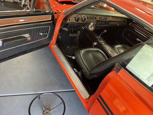

Besides letting somone touch the car. What the best way to make the wheels straight ots off to the right a touch?
Thx in advance guys.
The shaft has a notch so I couldn’t do it by removing the wheel, which i had to clean up anyway while it was off.

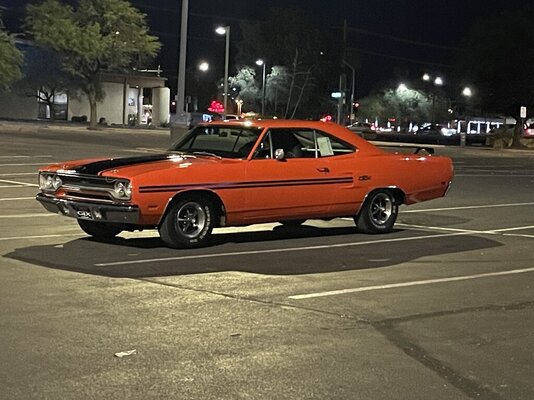

Took her out for a quick cruise with my Son some bonding time. Some eye candy for you guys “night shot”
Thats my Window sticker “copy”

I'm not sure what you're asking.
But I think what is annoying you is the steering wheel is just bit off center when you are going straight?
Assuming everything is "OK" that may be the result of someone not exactly centering the wheel when the toe is set.
Alignments are pretty simple really.
I use Fastrax.
At the risk of speaking blasphemy, one thing you can do is "eliminate" the index key on inside the wheel and shift it just a little on the shaft. :mob:
It's really just a reference point and makes no practical difference in operation.
Again, assuming everything is OK.

The adjustment is in the tie rods and you will most likely mess up the toe in doing it yourself but it can be done.

Correct the steering wheel is to the right a little bit. When driving straight.
7,715
3,252
When having my front end aligned told the guy to make sure the steering wheel was right. They used to hang a weight on the steering wheel when doing the alignment. This assures the steering wheel is straight when going straight down the highway. Looks good John. Thanks for the pics of that GTX. What does the engine bay look like. Do you think you got your money's worth. Have fun and safe driving.

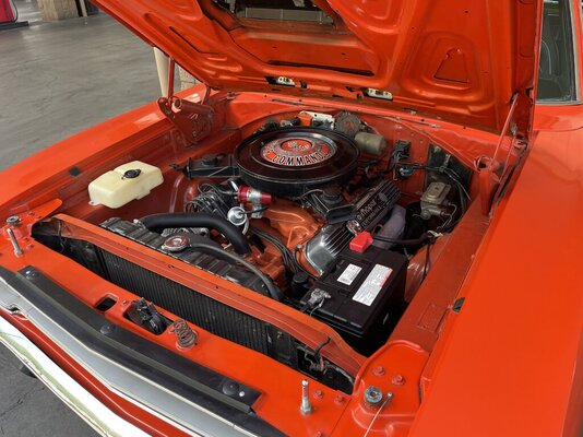

Here’s the engine bay pics looks decent but I really like to change the air cleaner to maybe an oval air grabber. I also need the air grabber piece that goes on the hood and also the flapper.

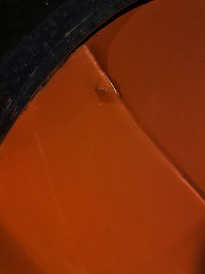

Did I get my moneys worth well the guy did not tell me everything. all the little things add up and they are expected, but there is a tiny bit of rust on one of the lower quarter panels that he did not disclose, I’m gonna just Move On and try to enjoy the car.

that'a nothing it's the lower rear quarter that has the bubbles
