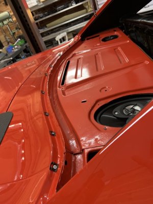

Is there anyone who knows the place of the clips on the dutch man panel for rear window trim did not mesure it before replacing it

Their is one in the curve 3 inches from the corner. Then spaced them out 41/2 to center from the first 4inches 7 inches 71/2 form center of the previous one. Then do the other side. Maybe someone else has an idea also. But that is how mine are on the filler panel or dutch man.

Say Oscar with the speaker's in the car are you pumping out tunes while working on the car. Just kidding. What spacing did you come up with. Russ.
