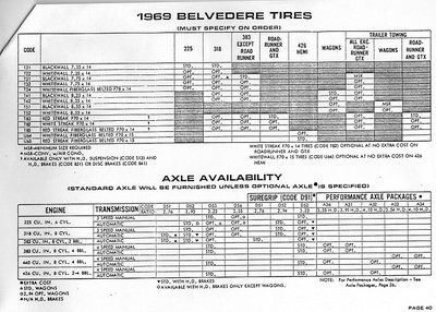

I dug up an old copy of my '69 Dealer Order Code List manual to share, and have attached a scan of page 40. It does indeed state that the 3:55 ratio was offered by itself as an option in the Belvedere with the /6 & 318 engines only...neither of which, of course, were available in a Road Runner. Regarding 383 powered Road Runners, according to the document, the 3:23 peg-leg was standard with a sure-grip version offered as an option. Only two other ratios were offered: 3:55 & 3:91. Both of these required the ordering of an axle package, codes A36 for 3:55 & A31 for 3:91. This in turn replaced the 22" radiator & core support with 26" versions. It also got you the 7-blade fan & shroud with viscous clutch, sure-grip diff, and 2 extra half leaves on the passenger side. Droptop, based on what I'm reading, I'm going to go out on a limb here and say that if your car was an original Road Runner, and originally equipped with 3:55's, then it had to have come from the factory with the A36 Performance Axle Pkg with the requisite 26" core support.
Comments, corrections, and public humiliation welcomed...........

Well done on the research. That's what I love about this forum - we are all inspired to do some research and learn new stuff about our cars. :thumbsup:
