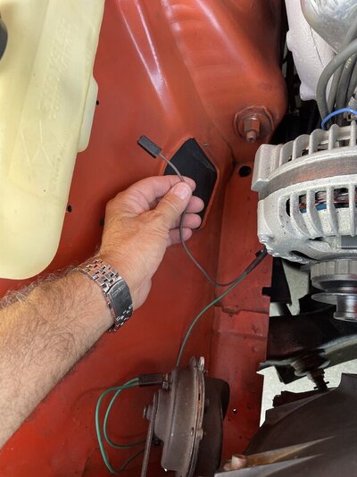

Question for the experts, is this brown wire for the washer pump? Sorry I don’t have a manual or recollect. Thanks in advance guys! TGIF!

use a test light and see if that is it turn key on put test light in the plug ground the test light have a friend push the button if the test light lights that’s it
