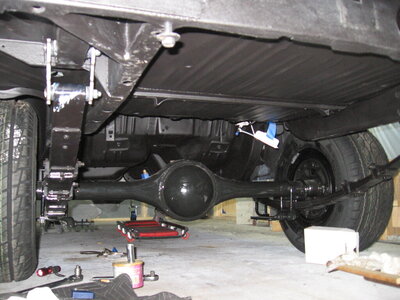

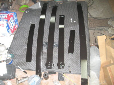

My spring's where shot so replaced with new one's. Might could get a shackle a little longer for that side if it is available. Just thinking.

New spring's are not that much. With all the other work you have done. The old ones are probably tired. Saw an option on rebinding them but don't think that is a good idea either. IMG_0103.JPG IMG_0102 (1).JPG 2 1/2 inch recurve.
