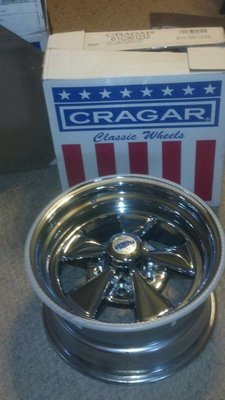

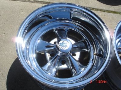

I Ordered the wheels this week. Cragar s/s direct drill 8x15(4.5 b/s) rear and 6 x 15 front Delivery should be 3-4 weeks. New lug nuts stems and lock have arrived already.
Budnicks
Nov 9, 2013
549
26
Sonora Ca.
good old Cragers look awesome, period correct too
