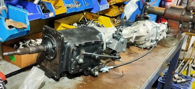

I'm running a 509 stroker; 275/60/15 rear and 235/60/15 front. Gears are 3:23 with a Detroit Truetrac and Gear Vendor Under/Overdrive unit. Overall it works out just fine. It launches solid and quick and cruises at 75 mph at 2600 rpm's, so you can have your cake and eat it too!!

7,846
3,425
That is a hand full. How much weight dose that add to the assemble. Would love to have one but that will have to wait for when the car has been on the road for a while. When you get it in want a low down on every thing. Like you rpm's and what it dose for the road on MPH. Look's good. :thumbsup2:
Your tach might be out? Should be closer to 2300 (2260) rpm with that combo and speed?

Yes, I will sure let you know how it goes. I really like the sound of that overdrive unit, but at $3k might have to wait a little while on that.
