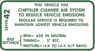

Mar 10, 2016 #1 TOMRR Well-Known Member Joined Dec 29, 2013 Messages 608 Reaction score 254 Location Mass Just wondering what to set the Idle on my 440, It'd a 69HP and I have a 750 Holley Carb. Thanks Tom C.

Mar 10, 2016 #2 69hemibeep Sponge Bob Square Wheels Joined Sep 10, 2008 Messages 22,326 Reaction score 2,544 Location AZ Desert, 5. LOL Stick? Auto? Stock cam? A/C?
Mar 10, 2016 #3 TOMRR Well-Known Member Joined Dec 29, 2013 Messages 608 Reaction score 254 Location Mass 69hemibeep said: 5. LOL Stick? Auto? Stock cam? A/C? Click to expand... It's a 4-Speed no AC or Power Brakes, Has Power steering, rebuilt to 69 Spec. so stock cam
Mar 10, 2016 #4 69hemibeep Sponge Bob Square Wheels Joined Sep 10, 2008 Messages 22,326 Reaction score 2,544 Location AZ Desert, 69 440 GTX would be the same
Mar 10, 2016 #5 Ranger Well-Known Member Joined Dec 25, 2014 Messages 1,462 Reaction score 250 Location Woodstock ll WOW! Timing was spec'd at only 5 BTDC? My 383 is spec'd at 10 and I'm about to bump it to 12.
Mar 10, 2016 #6 69hemibeep Sponge Bob Square Wheels Joined Sep 10, 2008 Messages 22,326 Reaction score 2,544 Location AZ Desert, Timing on a street hemi is TDC or zero. They don't run worth a crap like that.
