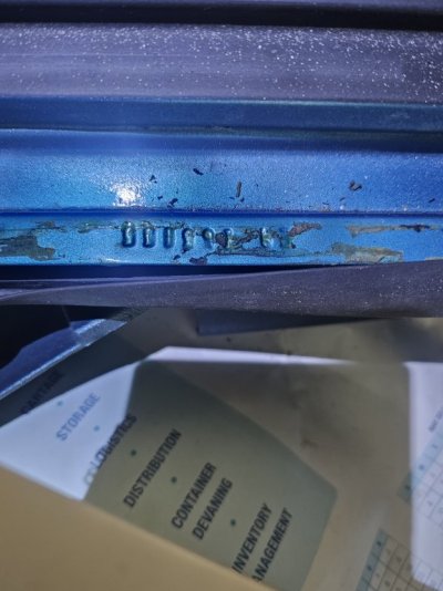

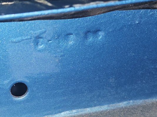

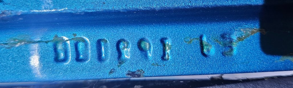

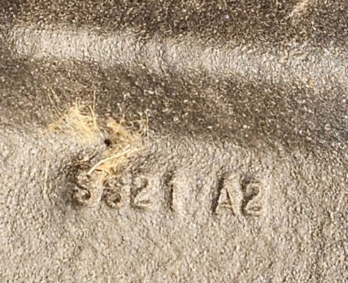

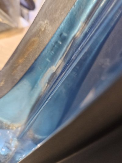

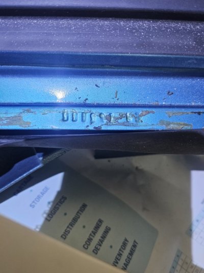

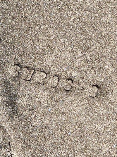

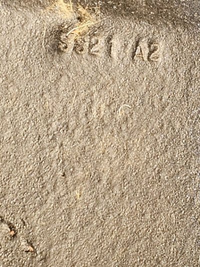

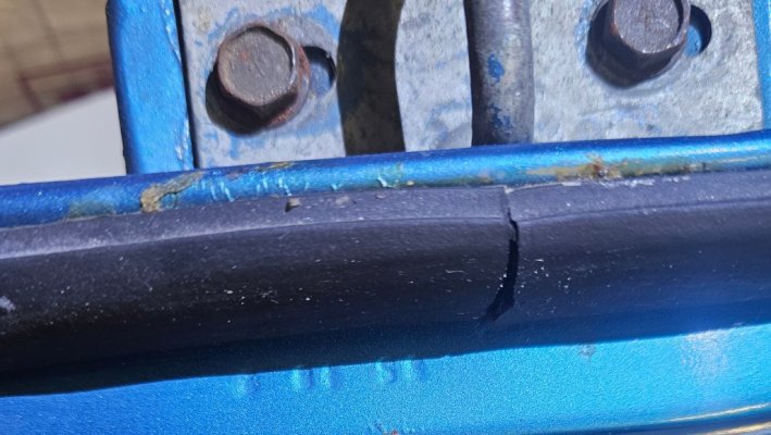

Hi my name is Donna and I'd really appreciate some knowledge on decoding the following images, I don't have a build sheet or vinplate identification only the boot drip rail stamp and a couple of other images ive managed to locate, off thr radiator support and under guards.
I would so be grateful for any assistance.
Thank you all in advance.
So you don`t have the dash vin plate? Other locations for the full vin number are drivers door sticker, fender tag located on the drivers inner fender under the hood or the broadcast sheet which is usually found under the rear seat. There are two partial vin numbers stamped into the radiator support and for `69-70 on the drivers side trunk rail under the weatherstrip, for `71-74 it is on the drivers side cowl area.
The pic with the trunk rail number is the only one that pertains to the vin number but there should also be one on the radiator support on the drivers side either top rail or back side of it. Unfortunately they do not give you the full vin number - E9 16xxxx decodes to - E = LA plant manufactured, 9 = year 1969, 16xxxx is the unique sequential assigned number but missing is the model code - RM, RS or RH and the body style - 21 or 23. Is there no sticker on the drivers door back edge or no fender tag in the engine bay, drivers side?
