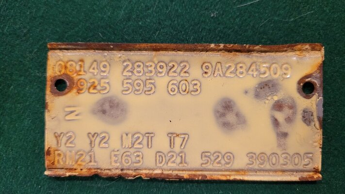

I'm having trouble with a few codes and thought I would ask for help with all of them. I'm fact-checking myself.
This is a Lynch Road Road Runner. Any help is greatly appreciated. Please see the RR Fender Tag.jpgattached picture.
22,287
2,538
See if I can get this
08149 =gate info
283922 = belvedere units built to date
9A284509 = partial VIN 1969 Lynch Rd plant
925 = engine 383
595 = 323 sure grip
603 = A833 trans 23 spline
Y2 = Sunfire yellow body
Y2 = yellow top
M2T = Medium bench Tan
T7 = Upper door frame paint dark bronze
Rm21 = 2dr Sedan
E63 = 383
D21 = 4 Speed
529 = May 29th
390305 = Sequence #
