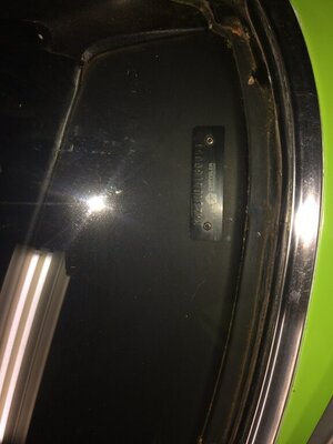

There are no bolts that I can see close to windshield, see pic. It's just completely smooth.

Best to pull the glass if you want the whole dash out. If you just want the cluster that can be done without pulling the windshield but I'm not familiar with a 1970
Yes have to pull window. This is the only bad thing about accessing those bolts. Plus bolt one each side where kick panels are. One where E brake is and the other on passenger side. Will need to get a new gasket for the window.
No kidding, under the rubber. Thankfully, I only need to pull the cluster, the dash pad above is good. Matter of fact now that you mention this about pulling the windshield I bet someone redid the dash pad at some point. The gasket around the windshield is the sloppiest I've ever seen, so someone did get in there at some point. I got the simple front bolts out, but still seems locked in place. Wondering is the speedo cable is tight so it won't move.
Cluster has several screws under the dash pad. Can be tough to reach. Speedo cable is attached but should have some slack enough to remove cluster far enough to detach it
