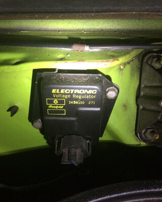

Was the test done with the engine running at idle? If you rev it up do they get brighter. Also do you have the original style voltage regulator or is it electronic. The electronic will help with the brightness.
Yes, test was at idle, I walked around car in dark. I'll check the voltage regulator, not sure on that. I don't think they get brighter with revving, but I'll start it tonight and see.

As far as voltage reg, here's what I got, don't know if factory or after.VoltReg.jpg
