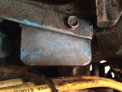

Hi all,
Found the engine serial code by the starter.
I wrote it down as 4906630 but I think it
Should be 4006630 as it is a little hard to tell.
If it is 4006630 that would make it a 1978 440 if
What I read on the internet is correct.
It also has a stamp by the water pump
See attached but I'm not sure what this means?
Any help is appreciated!
