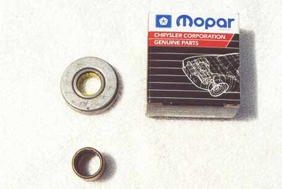

I have converted at least 20 cars in my time and I found that later cast cranks aren't drilled. The solution I came up with was to make a steel billet piece to put in the back of the crank to act as a drill guide and drill out the crank to the size of the pilot bushing. It works like a charm and takes 10 minute to complete. Then you install the bushing and run it like factory. The othe option is to trim the inPut shaft and run a pilot bushing from Chrysler that is used in the jeeps which goes into the converter pilot hole. Another thing to note is that while brewers and passon are very reputable companies that are great to deal with, there is a lot of money to be saved buying the individual pieces off eBay or swap meets. It usually costs between 1500 and 2000 depending on the deals you find. Brewers swap kit is 3-3500. I can list all the items and costs if you want me to.
