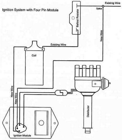

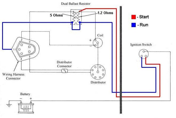

This is what Halifaxhops says. "4-pin works fine as a replacement on a five-pin system, but you can't use a 5-pin on a system designed for the 4-pin."
