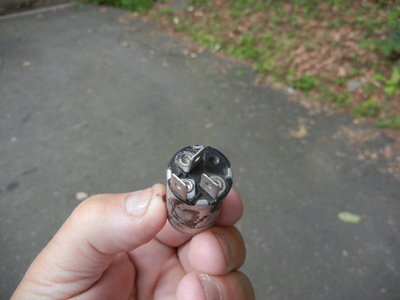

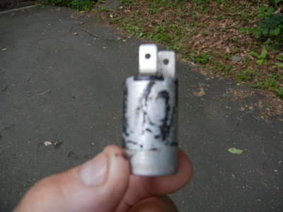

The 4 ways haven't been working on my car and I haven't really worried about it. But since I'm driving it to Carlisle I thought it might be a good idea to get them working. Does this look like the correct unit for our cars? I found it under the dash just to the right of where the key is. I could not find any numbers on it, just "Made in The USA!" I went to NAPA and I checked a few places on line and didn't find any like it. If this is the right one does anyone have have an idea where I can get one. Thanks guys!
No, I think that's the timer for the ignition light.
IIRC, the 4 way should only have two connections.
Thanks John. So I should be looking for another flasher then? It would be separate from the signal flasher, correct?
Yes, the turn signal flasher will have three connections.
I just went through this myself. I think what you have is the timer for the ignition light. If I recall the 4 way flasher should be in the same vicinity. The turn signal flasher is to the left of the steering column. The part is available from any store.

Thanks Jack. I took a quick look under the dash when I got home today and didn't find it yet. But I did find an empty 4 pin plug on the left side. I'll keep looking.
