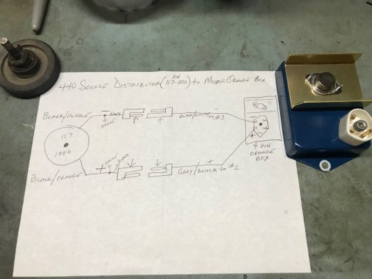

Has anyone used a 440 Source Dist 117-1000 with and orange box? The dist comes with an MSD connector, orange/black and purple/black wires. MSD says on it's connector, orange/black is positive. What are the + and - pins on the 4 pin orange box that connect to the dist pick up?
