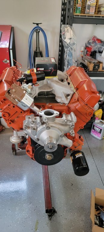

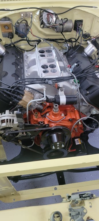

My friend just built a 440 for me and I had picked up a 73 mh block a couple years ago that was .30 over. I had a 69 440 hp I had picked up but the block was cracked. Mine has steel crank withe the b heads that have had work done to them. Mist of the parts for the engine are brand new to include trw pistons, oil pump, water pump, .555 lift cam all new bearings of course. He has a 68 that is being put back together with a Ray Barton 540 Hemi. Mine is about ready to be installed. Pics of the 440 and his Hemi.

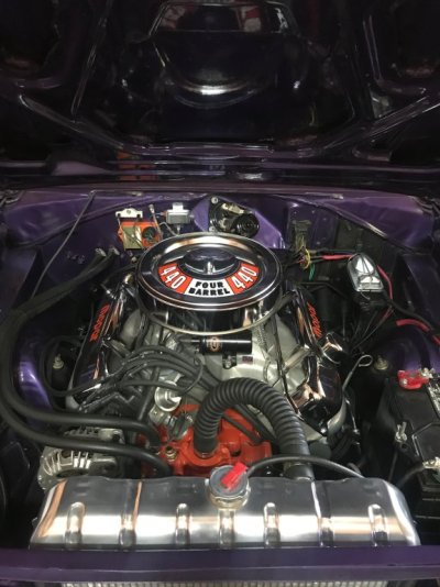

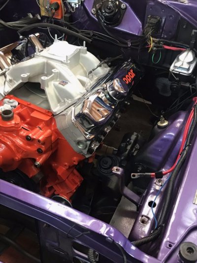

I used a 440 block from a 1976 Winnebago. I tore it down and had my machine shop clean, magnaflux, install new cam bearings, and bore it 30 over. I had a steel crank and LY rods. Got some Wiseco Pistons for about 10:1 comp. Edelbrock RPM Performer, 440 source heads. 509 cam, TTI headers and used my 650 Holley from the 383. It's a nice running and looking engine. It's only around 400 HP, but that's good for me. I'm older now and not taking it to the track. There's still room to build it but it's good for now.
