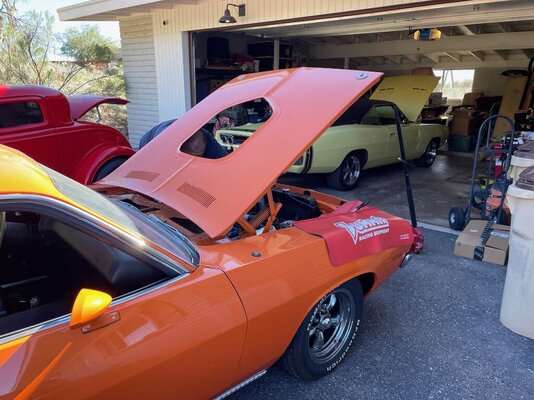

Hey guys my friend has a 70 real Cuda with a 383.

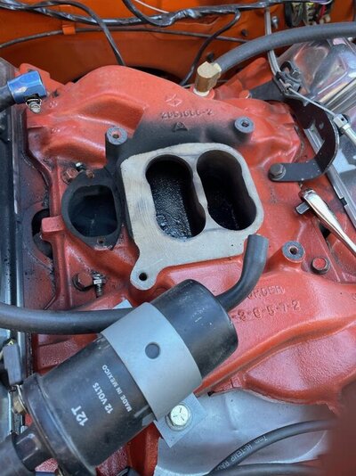

It was running rich so i took a look at it for him.
His factory choke was leaking right on the manifold. See all the carbon! Wow. easy fix.
So i took carb off and sealed the choke plate with red hi temp.
the choke opens now and no more leak.

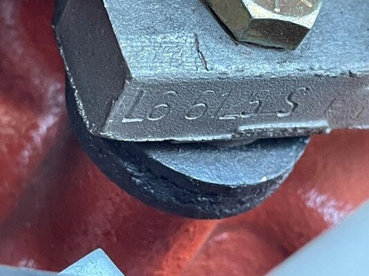

I was wondering if anyone knows what year carb this is?
He as a 68 383 in this car. when i look it up i cannot figure what its for.
Any clues? yeah nice cars right! ha ha
Enjoy the pics he has a 68 charger and a 79 cuda and that 32.6615 carb romans.jpg6615 carb roman 2.jpg70 cuda roman.jpg

I see a light stamping of a 2 in front of the 5. So I would call the number 6125 which makes it for a '71 383 A/T On the two lists I looked up the were no numbers starting with 66.
