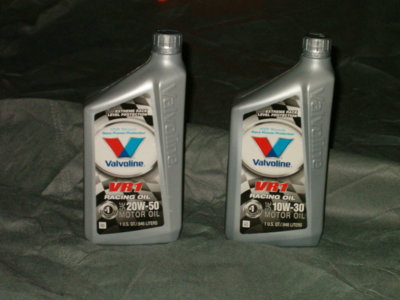

The gas evaporates out of the carb, very common. A little to much starter fluid can be damaging I prime mine with a little squirt bottle of gas. As far as oil look for a high zink content oil like Brad Penn and alike so you don't flatten the cam. The zink was removed to save catalytic converters.

Thanks for the info! What harm does the starter fluid do? Just for future reference.
Also what weight oil do you recommend?

Oil is a very personal thing, but I use Rotella T5 10W30 with a small bottle of ZDDP Plus on my original factory 383. The ZDDP Plus may not be necessary, but I'm a belt AND suspenders type of guy. Works for me.

I do remember years ago him telling me he ran Castrol but I don’t know the weight.
I will probably give 20/50 a try.
