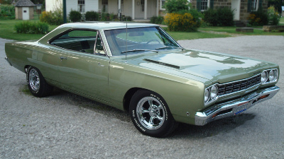

The tag #s are under the weather strip and yes should match.They might be different if the car was rapaired with donor parts years ago
A12

472
