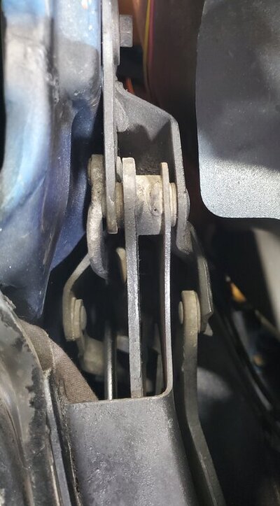

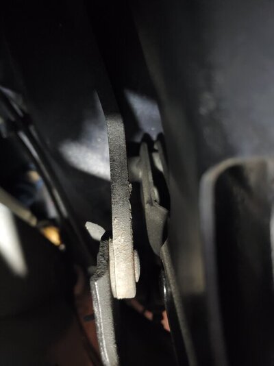

Jack, I tried to take some pictures and they don't come out. It's to tight down in the cavity to get a picture and from the top you can't see much. I'll back it out and lower the top and see if I can get to it better.

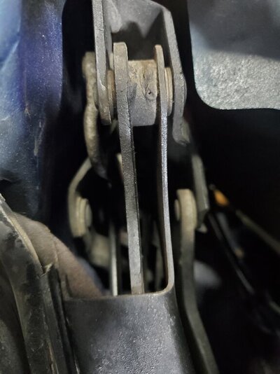

Don't know if this helps, but its about as good as I can get. I can't really get down inside, its to narrow to take a picture. This is with the top down.

Thanks. That does help. Just standard hardware. This weekend to top goes on.
