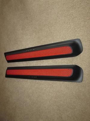

What was the correct / OE color or paint code for the air inlet screen for the 69 road runner / GTX air grabber? I'm in the process of restoring the car and want to get the correct color back on this.
mahoney0_00_3
Aug 19, 2013
358
whitehouse sta new jersey
it is chev orange I have a hood that I got that was off the car when the car was 2 years old and I color matched it and it was chev engine block orange I painted it and it match perfect crazy !
resq302
Jul 9, 2013
280
northern nj

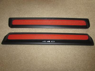

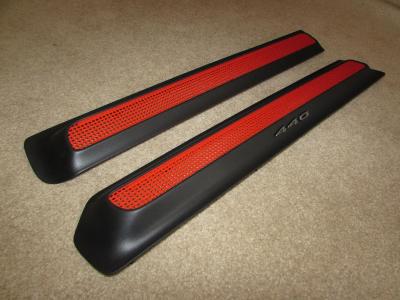

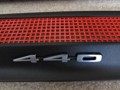

Hood scoops, engine size emblems, and air grabber screens all repainted and installed.

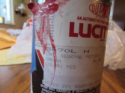

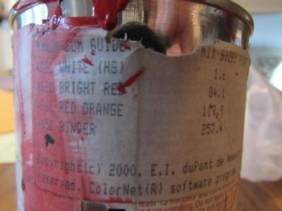

Here is the color code. Dupont Lucite 5470L H
