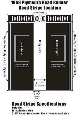

Is there some kind of a engineers diagram or someone have original pics of how the hood stripes were put on the 69 GTX and Roadrunners? Did they have a hard paint line or was it a soft paint edge down into the fenders and around the back edge of the hood down into the engine compartment? Also, what are the correct width of the stripes?
I know the paint was the textured organisol and had to be put on in ( I think) a cross hatch type pattern.
