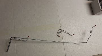

I just purchased a 1969 RR. Did all 69’s have the fuel tank breather hose installed in the trunk? Mine has none, and noticed today after filling up, fuel leaking from a breather hose that goes up through the frame and loops back down above the driver side of the differential. It leaked onto the differential and messed up the paint. Was it just a matter of overfilling the tank? Thanks for the help.
22,287
2,538

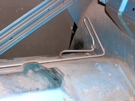

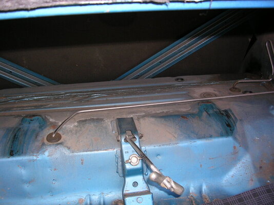

The long one is pictured the short one that is plugged goes to a missing steel line that clips to the shock support and curles down
Mr. Milba
Dec 14, 2021
33
38
Montverde, Florida

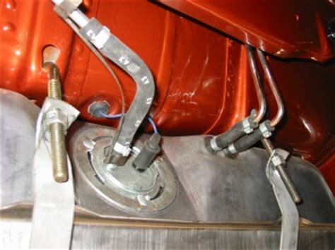

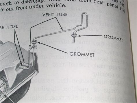

Thanks hemibeep. Just want to be sure I understand. Right now, the long one goes up through The cross member and curls around. The short one that’s plugged SHOULD go to the vent hose in the trunk? I just ordered the vent hose for the trunk.
Mr. Milba
Dec 14, 2021
33
38
Montverde, Florida
Gotcha. Probably why I had fuel coming out of the one that’s not plugged and goes up to the cross member. I’ll reverse, when trunk vent hose comes in.

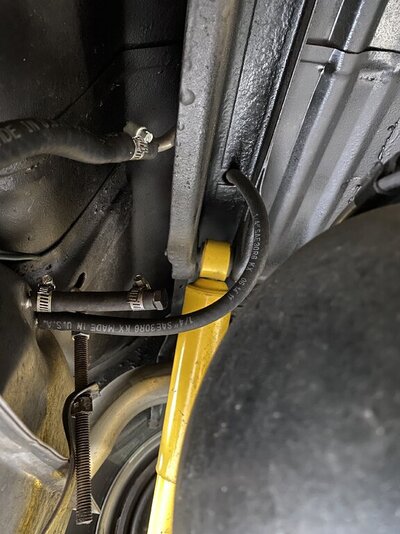

is it the same for aftermarket tanks as well. My tank has been replaced.
7,832
3,408
Found that the replacement tank vent lines where swapped just think due to patten's. Just to say I could not stop my vent line's from leaking and had to put a vent line on the filler neck to make it all work right. Had to do this because of the rake with the 2 1/2 inch recurve spring's I put on the car. Tank built up pressure an forced the fuel out the vent line's. Good luck and enjoy that runner.

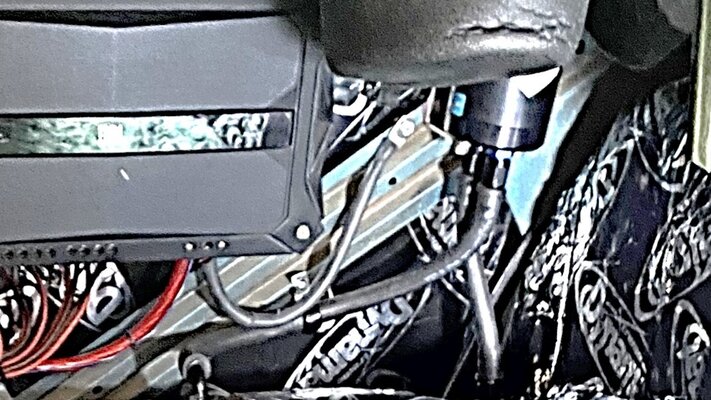

Back in the day (the late 60's and early 70's) we'd often add a second breather tube directly off the filler tube and, using a T-fitting, tie into the stock breather tube, thereby eliminating any fuel sloshing up through the original breather tube and onto the ground in front of the rear passenger-side tire. I did this to my current 69 Road Runner and although it worked for fuel leaking, it did nothing for fuel vapor orders in the garage. I installed a fuel vapor canister in the trunk and welded the second breather tube to the fuel filler tube and ran both breather tubes through the vapor canister and out through the inside of the trunk into the passenger-side wheel well.... problem solved for both fuel leaking and fuel vapor orders.
