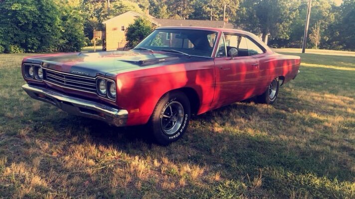

Hello there, looking to figure out what the best type of oil and filter I should put in my 69 roadrunner with a 383?? Live in NC

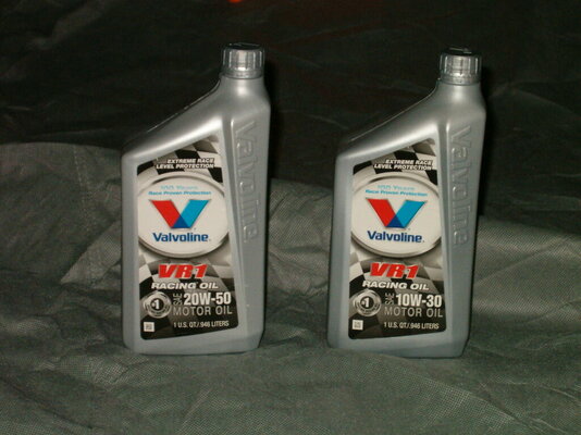

I use the VR1-20-50 myself and a Wix or Napa Gold

I run the VR1 in 10w-30. A 20w-50 will take a bit to pump when cold and take more power to pump.

Nice 69. Welcome to the site. Like a lot of guys have already said, I would run Rotella T4 and a WIX or NAPA Gold filter. Avoid people telling you to run synthetic, you need the Zinc. SO tell us more about your car, what options? Manual? Air? Pictures are nice also.
