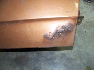

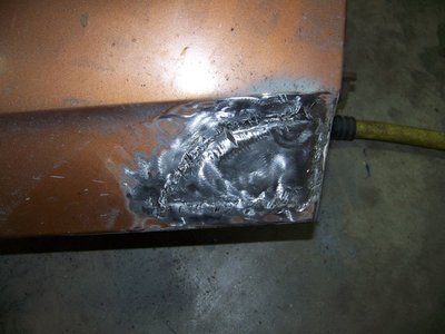

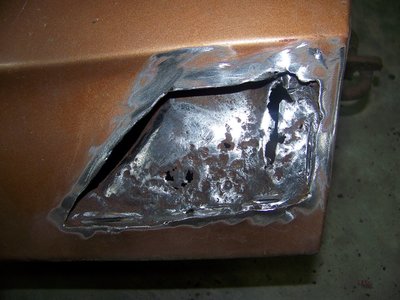

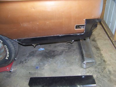

Spent the morning before work cutting out some body Rot, I still need to repair the back side of the door, about two hrs worth of labor on this so far. I also have the drivers rear quarter getting some mocking up, its still in the deep thought stage.

Ya know I have bought AMD panels all along, the best of it I think for the most part, but if you will look at the lower quarter pic I'm working on, on the black panel at the rear you'll notice a line,( that line), (The panel is too short) It does not meet up anywhere close to the end of my quarter, Thats why I said Im in deep thought about it, Ive got to cut around my existing marker and still match up at the end of my quarter...

Yea see what you are talking about. Bout got the package tray knocked out. Bought a spot welder for my Tig welder tried it on some test metal it worked fine. Tired of drilling holes and welding it up. This should speed up the process to finish the package tray and the filler panel for the trunk section. Yep just keep at it next will be the roof skin. Then the driver side rear quarter. Looking at trunk pan and drop downs. Keep at it if you slow down I am going to catch UP. Russ. :thumbsup:
