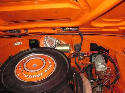

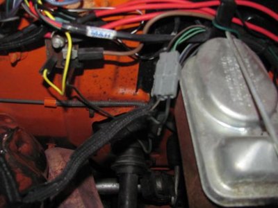

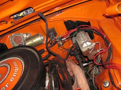

I don't know if this will help. The wiring harness was new installed in the car when we got it. We put the woven wire covering over the 2 black wires that ran to the indicators. The extra ground wires attached to the sockets we also installed because we had problems with grounding.

My 70 is missing the wiring too. I wold not have guessed it would be that thick/so much tape or insulation used.

Thanks for the responses and pictures. I looked at it and the wiring appears to have been replaced with harnesses from M&H, tag still on the harness. Looks like they just used a Satellite one, asked another harness manufacture about this and he stated all his for 70 Road Runners come with the pig tails for the hood lights. He is selling me the two wires and connectors I need to install so I will add in myself. Will use photos for reference.
