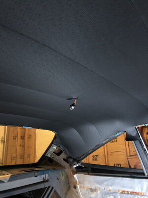

I did mine last spring, with some help from my buddy. We had it done in about 2 hours, and it went in without a fight. It’s pretty easy if you take your time and follow a few simple steps.

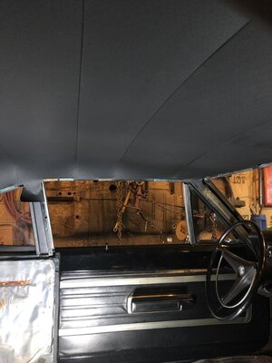

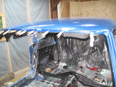

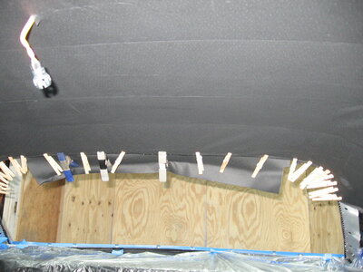

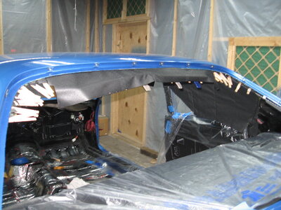

Did mine by my self. Start at the back. Make sure you have the bow attaching wire's at the back. Lots of clothes pin's and some of those tent clamps I call them form Harbor freight. Might want to let it hang a day once you get it to the front and pulled the sides. Do have to cut at the curved edges in the back window. Their is some U tube video's on the net for b bodies. Don't get frustrated walk away and come back. IMG_0103 (4).JPG IMG_0101 (6).JPG IMG_0102 (6).JPG Use a heat gun or hair dryer to get the wrinkles out or sag's if you have any. Don't get it too hot keep moving the gun or dryer.

Looks damn fine! Did you have to remove any glass aka back window?
Nope, all the glass was in the car. I wrote up a post of the steps I took to do the job, and kind of like Russ, I used some old welting pieces to hold the edges while I worked my way around and got all the wrinkles out.

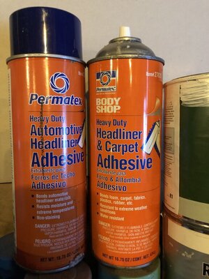

I don't even know what kind of glue?
But I'm ready!

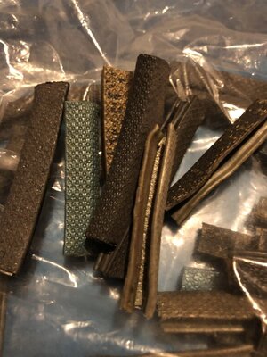

Here’s the adhesive I use, and the welting pieces I clip over the edges of the lip to hold the headliner in place while I work the job. If you’d like a step by step of what I did, I’d be glad to post it. I didn’t take pictures along the way because I was doing the job, but I can chronicle the procedure for you if you like.
