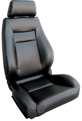

68 RR's didn't come with bucket originally, only bench seats, no big deal thou, either way there are a few nice comfortable racy seats available...

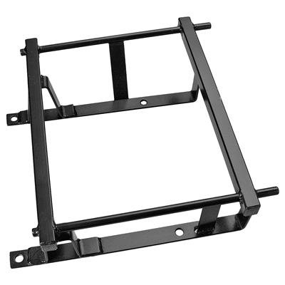

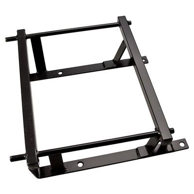

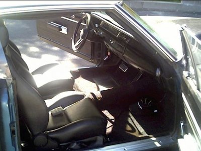

I have ProCar/Scat 1100 Elites, with adjustable head rests & backs, on sliders in my 68 RR, with their seat Bucket seat slide mounts, it was about $750 total a few years ago now, they have gone up some since then, Jegs & Summit Racing sells them, pretty reasonably priced & nice quality they have a couple different styles...
Procar Seat Adapdter Brackets Driver side SCA-81342 $77.95 Dodge Plymouth.jpg
Procar Seat Adapdter Brackets Passenger side SCA-81343 $77.95 Dodge Plymouth.jpg

Thanks for the replies guys. I like the looks of those ProCar seats in your 68' Budnik. I will have to check into those.
