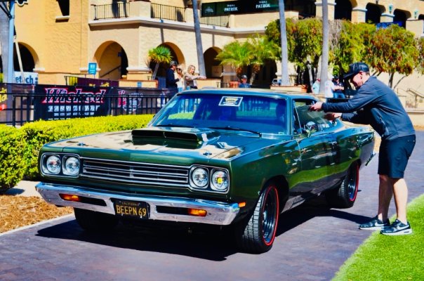

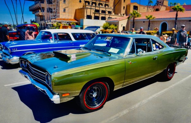

I’m sure I’ll catch some flack for the way I went, but will share nevertheless. When I initially purchased the 69 RR, it was an all numbers-marching 383 (special order car) equipped with a near-perfect air grabber setup. Knowing the stock hood would not fit over the engine setup (huge Indy with Indy high rise). I did have the stock “air grabber” air cleaner modified (lowered 2.5 inches) for the new hood fit. The hood is a fiberglass (hinged) hood (and “just” fits!! I sold the stock hood with air grabber setup for $100. The guy drove 300 miles to pick it up and was so impressed he tried to offer more… turned the generous offer down. All I cared about was it found a good home on another 69 RR.

The incoming air rushing through the scoop, through the original (modified to sit lower) air cleaner and into the EZ FAST 2.0 Injection System is the reason the car picks up so much torque throughout the launch mode. Add to that a Gear Vendor setup and sticky MT’s out back and that adds up to impressive 1/4 mile times.
