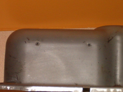

Got my AMD Big Block Valve Covers !! How is the best way to fill these weld debits they are smaller then a eraser on a pencil , Bondo or I was thinking JB Weld and then sand smooth

I have some work yet to do on them (Fill Weld Debits and Paint) as you can see , I have three nos pairs of diff. years and in my opinion there OK and will know better when I put them on the 440. I use cork gasket with a little Permatex Gasket dressing.
724
Cork gaskets will be fine if you are using headers, but if you have factory manifolds, I would use the hi heat gaskets. :cents:

Are they the heavy Rubber ones ??

I install them as is.
They have a high rubber content in them out of the package and I just tighten the bolts per FSM and good to go.
