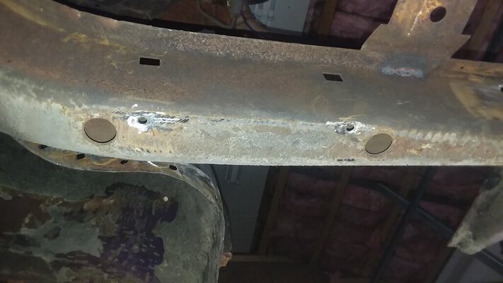

Another pic request- holes in rear frame rail and trunk cross member.
torredcuda
Oct 23, 2022
346
422
New Hampshire

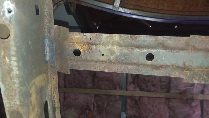

Passenger frame rail behind axle has two small holes, factory or did someone drill them? Trunk support/cross member has a small hole between the larger two on both sides, factory or someone drill?
22,251
2,495

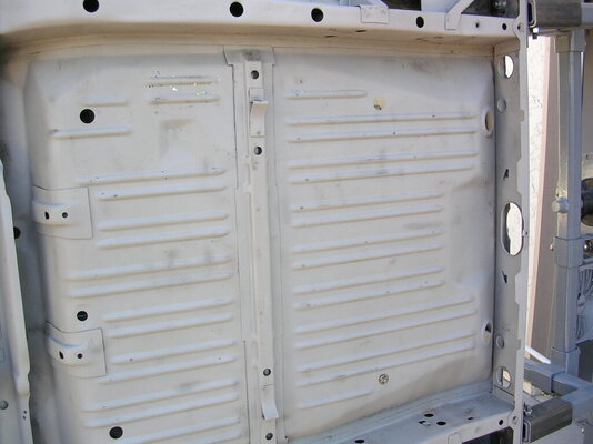

First 2 don't belong there the other is a spot weld hole for the gas tank centering brackets that are missing it appears

I figured the frame holes don`t belong and I think there was a fuel cell or some other non-stock tank mounted so they must of cut of the brackets - crap! I bet they only come with the support and I can`t buy them separate?

Over on FBBO a guy said the `70 had two rubber stops screwed in the support instead of the brackets. I actually had the rubber pieces I took off but thought they might have been added by a previuos owner. Anyone have a `70 that can confirm that they are supposed to be there? AMD shows the support s `68-70 but I don`t trust them as being 100% correct.

The story about the rubber stops looks correct according to your picture.
But I find it hard to believe that they would have put a "rubber" stop for a fuel tank locator.
I've done exactly one of these with the AMD repo part for a 69 and I also find the heat from the welds on the frame rail junction strange and not "factory".
Not much help but that's what think.
The way I found it was bracket spotted to the rails and the pan spotted on top of it.
