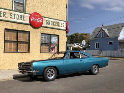

I think these are That very size and offset, on the front at least, the rear may be only 3.75 backspacing. There is plenty of room for a 4.5” back spacing. You won’t have that much of a dished look with 4.5 back spacing on an 8” wheel. But, They will fit fine
