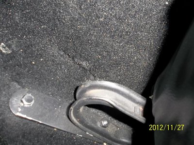

Hey guys, anybody tried anything to move the front seat back a few inches? I'm 6'3" and really long legs and I gotta tell ya that driving her is not easy or comfortable. For the 1st to 2nd shift, I need to be sure my legs are together and away from the shifter. Not very comfortable. Any way to move it back? Anyone done it?

It would be pretty easy to do, there are just 4 studs on the seat tracks that go through other floor. You would have to figure out how far back you want the seat? Drill the holes and fill the original holes. Might have a issue with the seat belt though?
4,001
731
Being 6'6" I have done this many times. What I do is get 4 pieces of .25" plate steel cut in 5"x1.5". Drill 2 holes in each of the plates 4" apart. Take the seat out and remove the studs from the seat tracks and bolt the plates to the tracks using carriage bolts. Using carriage bolts again, bolt the tracks to the floor board. This will move the seat back 4 inches. The best part is you can reverse this with out any evidence to the car except the original bolts in the tracks will be carriage bolts. Don't use any thing less than .25" stock because it will not be strong enough.

Droptop, I don't suppose you have any pics of this configuration?

Found a place www.metaldepot.com in Kentucky. Ordered 4 .25 x 1.5 x 5 plate steel. Delivered for $40, not to bad. Can't wait for the seat to be back. I guess the idea of this is I'll use the "front" hole in the steel plate to bolt to the floor pan and the "back" hole in the steel plate to bolt the seat to, thereby setting the seat 4" apart (or whatever distance between front and back holes).?

I only do the driver side bucket. You have to adjust forward at shows and cruise ins, otherwise your seat looks like it is broken.
82
If I remember right, the bench seat tracks have an extra set of holes that you can use to set the seat back another inch. I know I did this in a 68 Chrysler and I think I did the same thing in a Roadrunner.
An inch doesn't sound like much, but I'm 6'2" and it was good for me.
