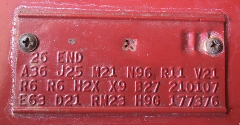

Jun 30, 2021 #1 rustyiron Member Joined Nov 16, 2011 Messages 19 Reaction score 9 Location Texas How to tell what plant the car was manufactured at? I will try and post a picture of the finder tag if that helps.
Jun 30, 2021 #2 Roadcuda Well-Known Member Joined Sep 10, 2008 Messages 10,564 Reaction score 311 Location Rocky Hill, Ct It's in the seventh digit of the VIN. A - Lynch Road MI B - Hantramck MI C - Jefferson MI D - Belvedere IL E - Los Angeles CA F - Newark DE G - St Louis MO R - Windsor, Ontario Canada
