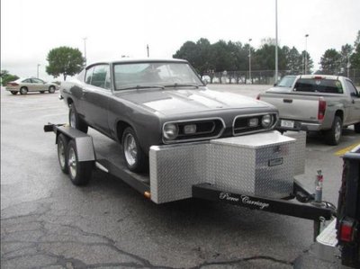

Make sure you have brakes on both axles. It's illegal in a lot of states to only have them on one axle. Better to have real trailer tires, not used take offs from trucks. Get a winch mount too, even if you don't have a winch... You will eventually.
Mine...
