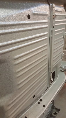

I used it as sound deadener on my quarters and in the wheel wells. Shake it up real well use a cheap schultz gun and it comes out as ugly as the factory stuff.

I just used WURTH 0892072 and a Schultz gun on the wheel wells too.

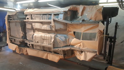

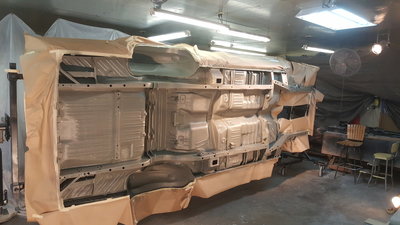

:thankyou:Hey Sity ninebird. That looks awesome. Wish I had a rotisserie working off a creeper what a drag. Keep up the good work. Russ
