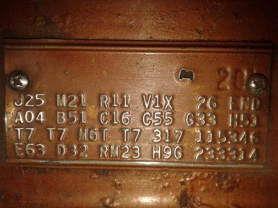

Hi, I have a 69 RR. I don't know what all the ciphers mean. I like to restore it.
J25 M21 R11 V1X 26 END
A04 B51 C16 C55 G33 H51
T7 T7 MGT(or M6T) T7 317 115346
E63 D32 RM23 H9G 233314

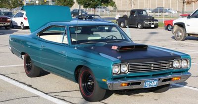

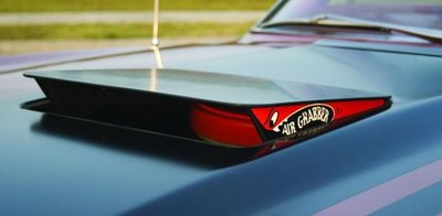

If I understand this correctly, you want to use a 1970 hood? Or do you mean A12?
The 1970 hood won't fit and I've never seen a sales brochure that shows an A12 hood.
301
that would be my guess, the '70s had the shark mouth....

i think this bloke is trying to say he wants to use this hood, but to pass rego in switzerland he needs to prove it either
a - came on the car as stock , or
b - was available as an option.
my broken english is great!
22,297
2,549

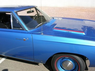

Two hoods were used in 69 the first was used on all roadrunners except the A12 cars The second was the A12 440 6bbl package
As supplement I will a A23 Hood. ( The Black with the Shark mouth) The Problem is, for the Swiss Traffic law, I need a copy or something from a Sales Prospect from a A 23 with this Hood. It means, they need to Know, exist Road Runners with this Hood....I hope you understand. My English is not Oxford like...lol...
Thank you
Roger
Can any of you experts help me with the fender tag for a 1968 road runner I am looking at. It was built in St Louis as was the 1969 referenced in the data plate above. The data plate for the car I am considering has that 3 or B punch through the data plate.
Mine is between the PNT and UBS headings. I initially assumed it was a red flag but now see a similar (not exact but very close) punch through the data plate on this 1969 car from St Louis. Is it legitimate and if so, do you know what it represents
I also see the tag on the 1968 car I am looking at has what might be larger numbers in upper right corner of the data plate much like this 1969 example (except on mine, they are more just a flattening of the data plate instead of clear numbers on this sample from 1969. Any idea what these are and if they are good or bad
