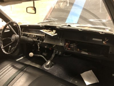

Just sent the dash pad,lower pad and the glove box door to just dashes to be restored. I won’t get them back until March or April.This is what it looks like in the car now.

Yep look's good. This must have been before you got the instrument panel done. That is the type steering wheel I had it was all broke up so got one with the half horn ring and the roadrunner in the steering cap. Like the shift ball. Russ. :beep:
I would like the have that steering wheel also.

I agree. It is what I was use to seeing in a runner. Had to get something mine was all chipped up and could see the steel core. So really had no choice had to get a better one. That is why I looked for this one. Think I was lucky to find it. You just have to look here for item's for sale or other site's as Ebay. Good luck with the car my brother. Russ.
