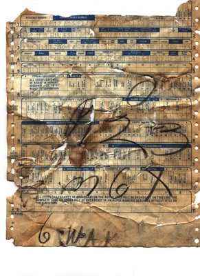

Put a decal on it. There is no place on the broadcast sheet or fender tag code for the decals to be added or deleted that Ive ever seen. If you have the broadcast sheet they may have wrote something on it. For example mine shows 6 way seat, I think as a reminder because it is coded on the broadcast sheet to get one also.
No broadcast sheet, but thanks for the advice.
