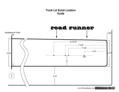

Deck lid script location

That is not in my info. Would you like for me to measure mine? My sticker is in the wrong spot but I'm sure the holes for my emblem are correct. The doors still have original paint on them.

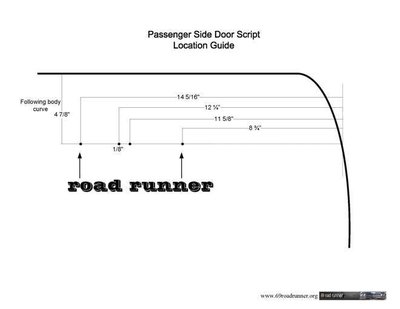

I have the diagram for the doors just like the deck lid some where is this stupid computer. I just can't find it right now. I stumble across it when I'm not looking for it.

when i put the door decals on, i used a set of original doors for placement and have been told by others that they are not placed correctly. with that being said i don't think there is an exact placement as long as it is close.

The original stickers had a small tab on the bottom to locate it off of the emblem. The dust swirl should be centered up with the center of the emblem and about 1/2 inch in front of it. I'll try to post a pic of an original sticker.
