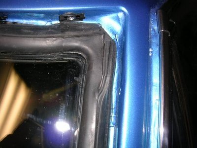

Has one built into the gasket you fold in. Here is the last couple of inches of the lock at the top before going in
