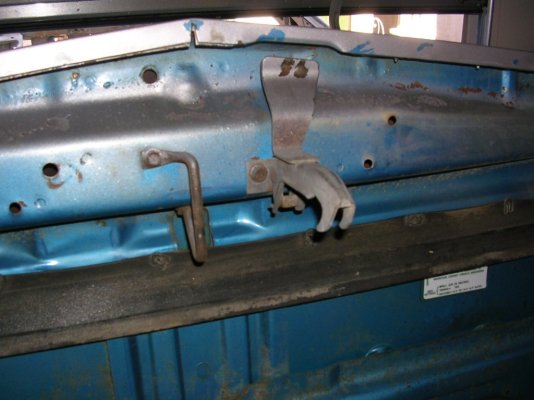

Measure from some bolts to say the drivers edge of the hood and I'll compare them to my 69 or you can compare to this pic

I can only measure from where the latch on the grille support is located, the hood that's on it is complete junk, the owners that I bought it from removed all structure from under hood, and used L brackets to bolt hood on to car, I'm replacing hood and both front fenders
