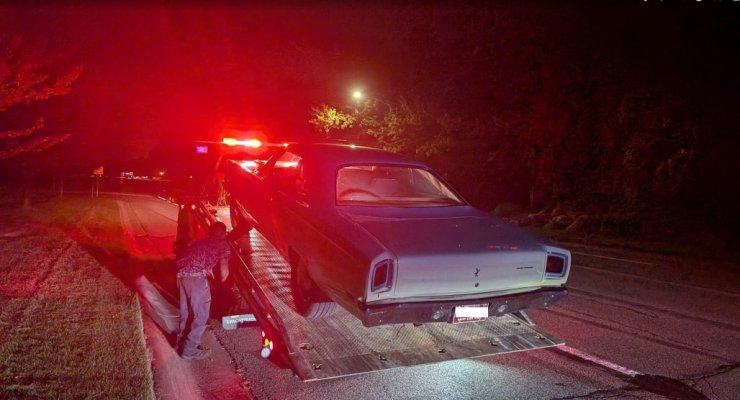

Well, I found out the hard way. Short answer: The alternator failed. I checked all the wiring connections at the alternator, but nothing appeared suspicious. I also checked the wires on the ammeter; they were good, and the ammeter didn't feel warm or hot to the touch. So I went for a test drive, everything was running good. Then the ammeter started acting erratically, the engine started to die, there was a loud backfire, and then the car went dark. Lucky for me, the fuseable link worked. The link burned, and the bulkhead connector melted a bit. After this happened, I checked the wiring again, and I found the charge post on the alternator was loose. The wire is tight to the post, but the whole post is loose. This wiring is original, which means it is time to replace all of it from bumper to bumper. I know there are factory replacement kits out there. Now I need to find the right one for this car.
Thank you all for your ideas & suggestions.
