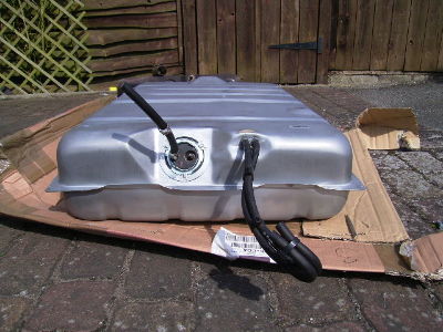

Here's a pic of mine.I had the same problem if I hit the brakes to hard petrol would come out the vent tubes.I tied the tubes as high as possible and now no problems.
Steve, thanks for the great pic. I see you are just using long rubber fuel line for your vents? I'm using pre-bent metal ones that I believe is what the factory used. I don't think it's actually coming out of the tubes, I may have a leak in the rubber hose that I'm using to connect the metal vent tubes to the tank. Going to see if I can find a vented fuel cap as well. I'll keep you posted.
Steve, if I do away with the metal vent tubes and do what you are doing with just the rubber hose, what do you do just use ties or clamps to hang them above the tank?
Thanks,
J
I use cable ties.
