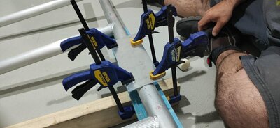

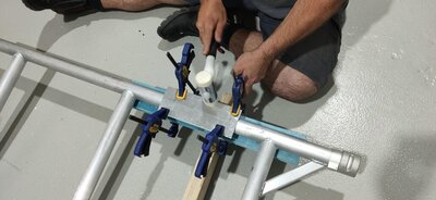

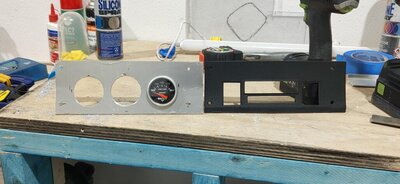

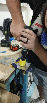

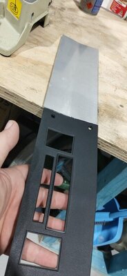

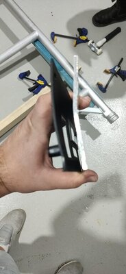

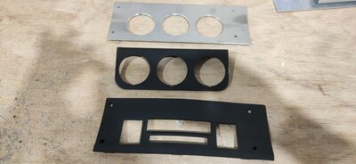

Been reading and watching a few of you guys mount gauges in the radio delete plate. Decided to delete my own radio in favour of some actual gauges now that Ive gone with a solid roller setup. Here are a few pics of the fab.

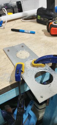

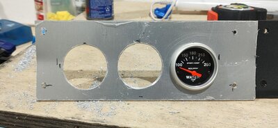

Used an auto lite under-dash gauge cluster as a template for the holes, also checked the clearance behind the plate - the actual opening that the radio slots into - and found that it is not actually the full size of the plate, so positioning of the gauges was critical.
I will be mounting 3 x 2 1/16" guages in place of the radio, and they look to fit pretty snuggly.
Had a mate with some panelshop experience help me with the rolling. Backyeard job, but we got there in the end. The plate I cut out of some 3mm aluminium sheet I had lying around. Abit thicker, but nice and sturdy, not like the old raadio cover plate.thumbnail_IMG20200521163311.jpg thumbnail_IMG20200521163315.jpg thumbnail_IMG20200521163517.jpg thumbnail_IMG20200521163525.jpg thumbnail_IMG20200521171720.jpg thumbnail_IMG20200521171734.jpg thumbnail_IMG20200521172107.jpg thumbnail_IMG20200521172110.jpg thumbnail_IMG20200521173750.jpg

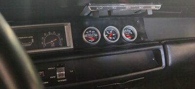

Thanks. Any tips for getting the paint to have that rough finish of the original cover plate? I think the current finish looks almost too good to paint as is, but it will stick out like dogs balls in my all-black interior if I dont paint it.
Have bought wrinkle finish paint in the can at Auto zone. Other than that TCP Global sell it. I bought a quart to do my dash. Lacquer paint. But you would think it would be in a spray can. Better for a spray can than a hole quart at 75 dollar's. Just a thought. The plate look's good.

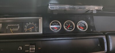

Went with a Matt Black finish, it was closest in colour but not finish. Found a satin finish that was super close, but colour was way off.
Was itching to get it back on the road so just bit the bullet. Figured I can always remove and resprayif it bugs me that much.

Like the blank you made for the A/C vent dash. Dose make it look better. Your gauges turned out good also. :thumbsup2:
That one was already in the car when I purchased it Russ.
Gauges only just fit. The plate is huge, but the gap that they have to fit into behind it is not massive. Nor is it centred, L-R or top-bottom.
