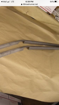

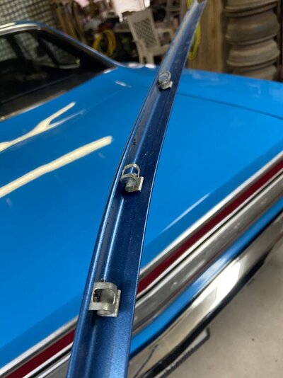

DF8ED949-654E-4D3F-8A88-10BE65037FDD.png Hey Russ, not sure exactly what the question is but the metal trim on the headliner goes across the post area to cover the edge of the headliner, carful not to cut it to short there’s not a lot of metal there to cover. DF8ED949-654E-4D3F-8A88-10BE65037FDD.pngDF8ED949-654E-4D3F-8A88-10BE65037FDD.png
It is ok 1968 man. Their is a gap their where it raps the post. Or where it is notched. I have the post trim Think that will fill it up some. But was their a piece of wind lace between the post trim. Thanks for the pic's. Tomorrow is the day and going to tackle it putting in the head liner. That is. Russ..

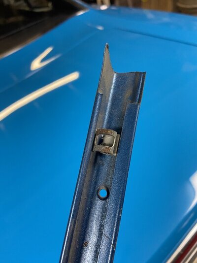

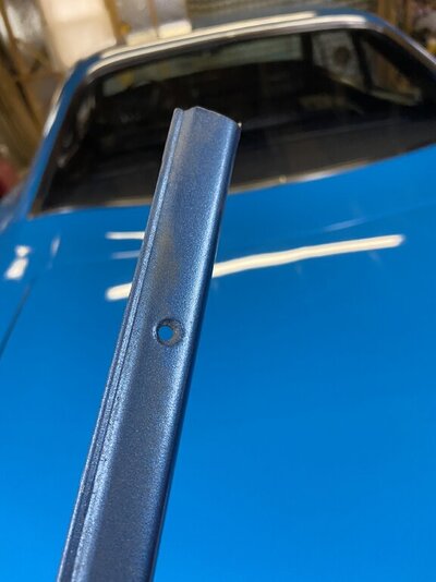

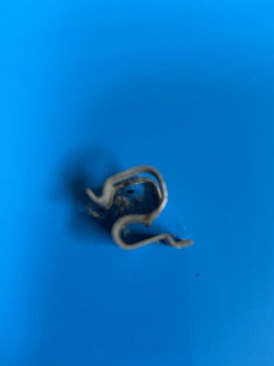

They have special clips that slide in the back side to hold it snug and two screws on the top side front and back. If you need pictures let me know and I’ll post them tomorrow.
thanks for your reply. I have no clips or holes to screw through.
any help of pics would be appreciated!
Thanks for the reply with pictures, I do have some of those clips but no holes.
I'll figure something out now that I have a better idea.
